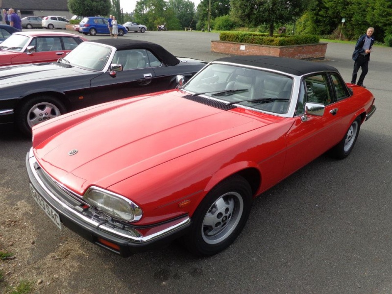

I can’t seem to find why some XJS are built with thier windscreen wipers parking on different sides. Perhaps if I explained you might follow what I meant.
I have a RHD Convertible, where the wipers park over on the LH side (in front of the passenger) and sweep water across infront of me on the right. My LHD Convertible is the opposite way round, with the wipers parking infront of the passenger and sweeping water across infront of the drive (me). Now this to me seems the wrong way round, as my logic says that the water collected infront of the driver should be swept away from them, not more added to what’s already there.
Both my RHD XJS Coupe and XJ-SC Cabriolet have the wipers parking infront of the driver, and sweep the water away across to the passenger side – and give a much better wet weather experience.
So, what I’d like to know, is if there is some kind of pattern to what way round the wipers park – because from my experience above I can’t find one….

      Well I did wonder how long it would take for someone to ask the question we have been asking for over 20 years. No one has ever come up with any thing better than “it’s what was available on the production line at the time” Here are two UK Cabriolets parked side by side followed by Steve Tebben’s 2 US Cabriolets parked side by side. So It’s nothing to do with LHD & RHD just the luck of the draw Concours Judges in the past have tried to deduct points telling the competitor they were parked the wrong way
      [photo 490] [photo 491]
