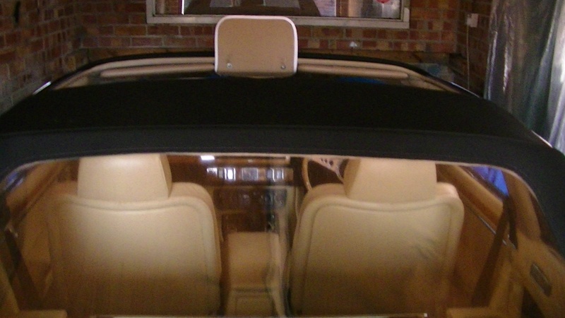

Look I made my own [photo 378]

13th February 2017 at 10:30 #2705Bryan ThomasParticipant
The picture above is of the wind deflector I made, by useing a right angled piece of trim I had laying about that had come from a XJS convertible that had the locker box and trim removed. I have only seen pictures of the original one but it looked like it might do what I wanted.It was already covered in Magnolia trim one side so all I needed to do was cover the other side , I had some spare headliner material which I glued on, I then finished off with some plastic edging strip . Next job was to align it up in the centre. After removal of the targa tops I removed one 2ba screw from each of the locker latch brackets in the top front of the windscreen, Then holding the deflector up to determine the space needed to allow for the interior light I marked where to drill the fixing holes. Putting the Chrome screws from the targa brackets safely to one side I found suitable longer screws with washers and fitted the deflector. I know its not as pretty as the original and it don’t fold back but it does what I wanted and stops the buffeting . The down side is of course having to change back every time, but there again if you only have a hard top in place and you want to enjoy your cabriolet to the full its worth considering making your own . Regards Bryan.
13th February 2017 at 10:47 #2706Bryan ThomasParticipant
Further to my discussion , I would like to point out that the buffeting is most apparent only when the solid hard top is fitted hence the need for the wind deflector. I never have a problem with the soft top possibly because the soft top section is more flexable

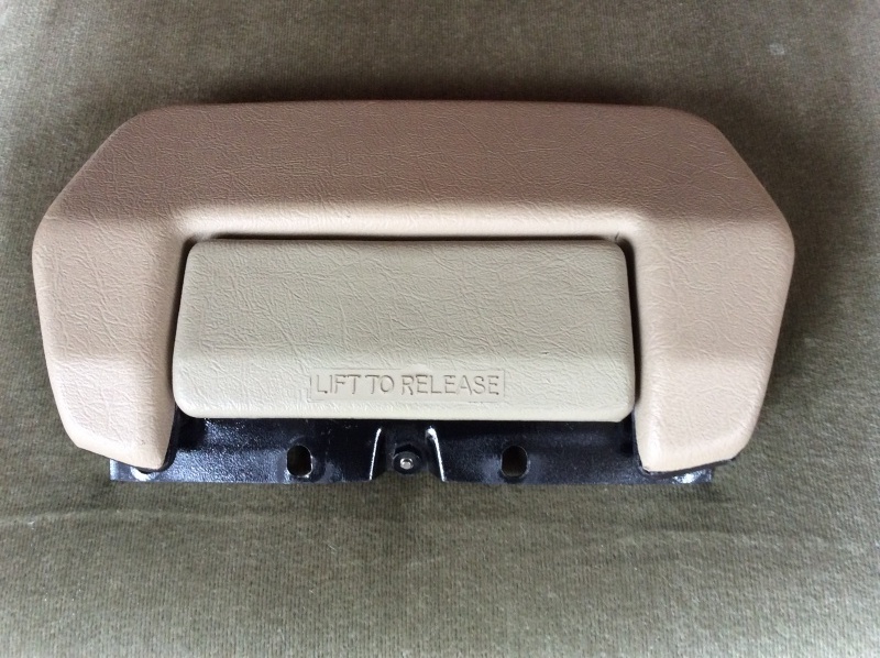

14th February 2017 at 12:01 #2751RobinParticipant
Hello Bryan, I couldn’t see your pic of diy wind Deflector but thought you might like to see mine!
As you say these were only sold for use with the hardtop fitted when targa panels are removed, mounts under the targa clips and is nicely made.
I’ll stick a few other pics on my general photos as I know you will be interested if you have gone to the trouble to make your own.
Only came in one colour I believe but mine is both doeskin mainly and the release panel in a slightly darker hue.
[photo 359] -

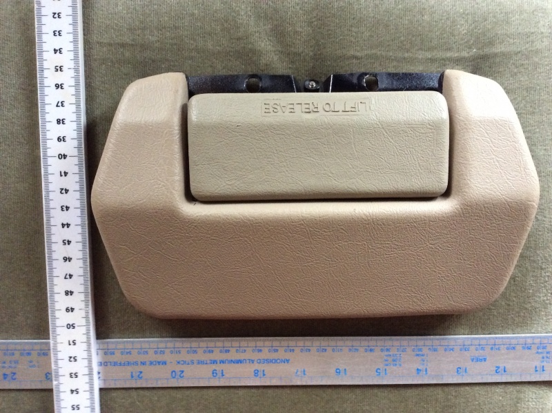

14th February 2017 at 13:14 #2755John BleasdaleParticipant
Hi Woodstock
I certainly recognise the photo I could visualise it days ago but could not remember where it was thanks for reminding me.
I remember it must be circa 1990 Duncan came over to Grimsby and took 100’s of photos of 92 HOT about 15 appear in his book,
along with some of Bryan’s Cabriolet 841 BRY. —Is it OK Woodsmoke to copy two of the photos to put on File.
[photo 366]
[photo 359] -
