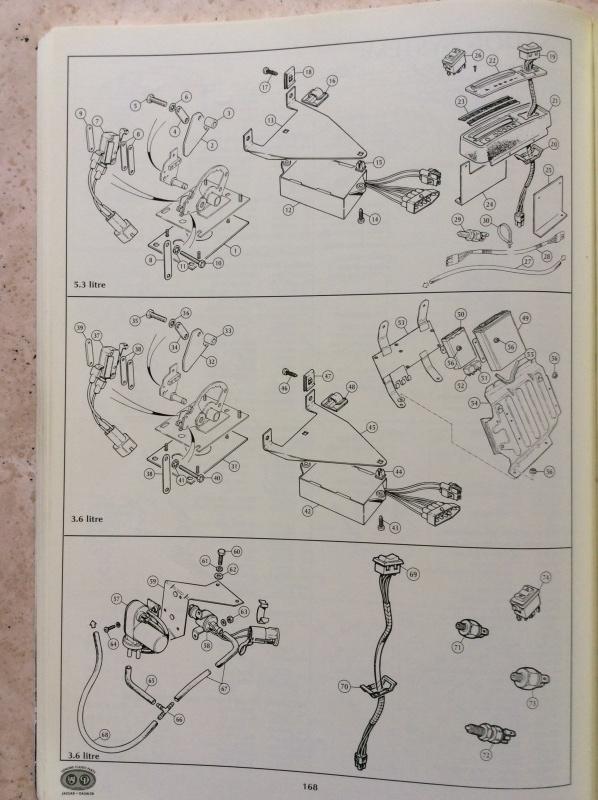

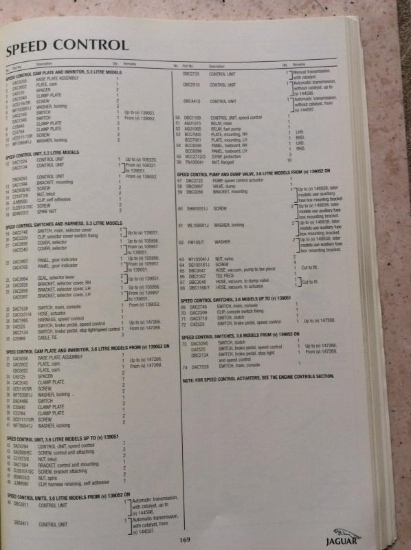

    • #3608
      Parts References for 3.6l Cruise Control – poor pics but shows where to get the info!
      [photo 510]
      [photo 509]
      [photo 508]
