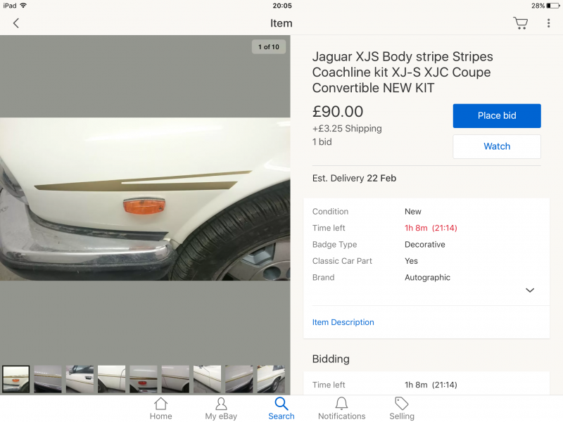

      Hi Roland, Not seen any original coachlines at dealers but a few occasionally on eBay. The pic above of an eBay listing is for reproduction coachlines.
      The originals came in 8 sections and cost £250/300 many variations but mainly pre HE ( no side repeater indicators), pre 1986 were thicker stripes as per eBay listing above, 1986/87 were thinner and the Sportspack different again with colour combinations.

      For some reason can’t add a pic at moment but Bleasie’s picture of 70GXX will be the correct size stripe as in eBay listing, probably in a light grey but maybe someone with earlier Parts cat can reference colour for Regent Grey/Saville leather 1985 model..
      Determine correct Pantone colour and then talk to the eBay seller as to feasibility..
      Hey Presto coachlines in post!
