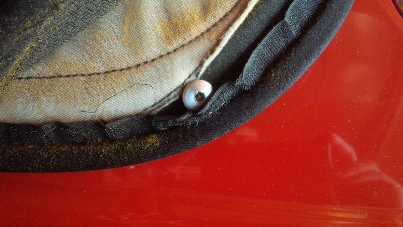

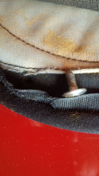

Hi there, I have one Allen Head bolt on my soft top that is loose and just won’t grab anything when I try to tighten it up.  Two photos attached.  Does anyone have any experience with these bolts?  Should there be a secure nut on the body to mate or has a nut fallen off somewhere?  Do you know how I can get to underneath the cover from inside the car to secure this bolt, Many thanks in advance, Martin[photo 1164][photo 1165]

      Its no help but I’ve had the same problem – I have a few “loose”. The screws are chromed and always in good condition, but they must screw into something which either rusts or is a captive nut which comes loose or disintegrates over time. Recommend that if the others are OK, unscrew them and lubricate to prevent further deterioration! I’ve not checked to see if you can access these from inside – probably not an easy job.
      Norman.

      Thanks Norman, it is  impossible (for me) to get up and under to locate the ‘nut’ as such
      What I did notice was that with all my pushing trying to get it to bite the thread on the screw was a bit damaged.  I found a longer bolt and it grabbed nicely and it is secure.  I suspect the thickness of the material was just too much for the screw to grip.
      Anyway, minor issue but fixed so that’s good
      Cheers
