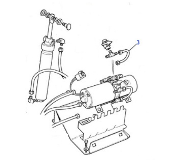

I have a question about the hood hydraulic system, what fluid do you use in the system in the UK or anywhere else actually. I think we may have a leak in our car’s system which I have to investigate over our winter (Australia) and I don’t want to put the wrong fluid in the system if it needs topping up.

      Hi Brian,
      According to my enquiries you must not use brake fluid, as there is a specific fluid for the Convertible’s Hood’s hydraulics.
      The advice is to go to Jaguar direct and buy the specialist fluid from there, do not risk using other products.
      Hope that helps,
    • #25867
      Brian Spencer
      Thank you Laurence for sourcing that information and excellent advice, it is much appreciated. I will definitely go down that path.
