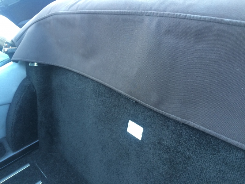

    • #6159
      Hi Martin Ball ( @ball )
      Here are a couple of photos of the my Tonneau Cover fitted that doesn’t have any poppers – it just has Velcro on the boot side and nothing to clip the cabin side down
      [one_half][photo 768][/one_half][one_half_last][photo 769][/one_half_last]

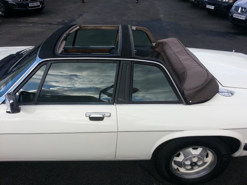

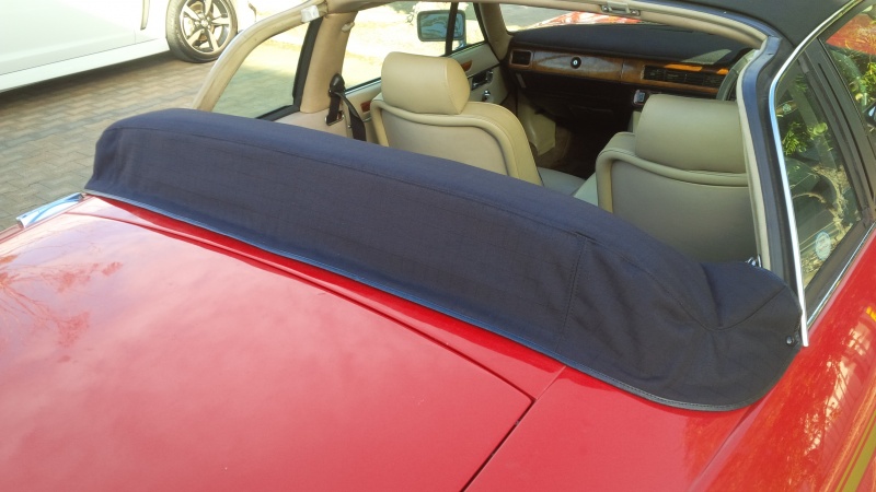

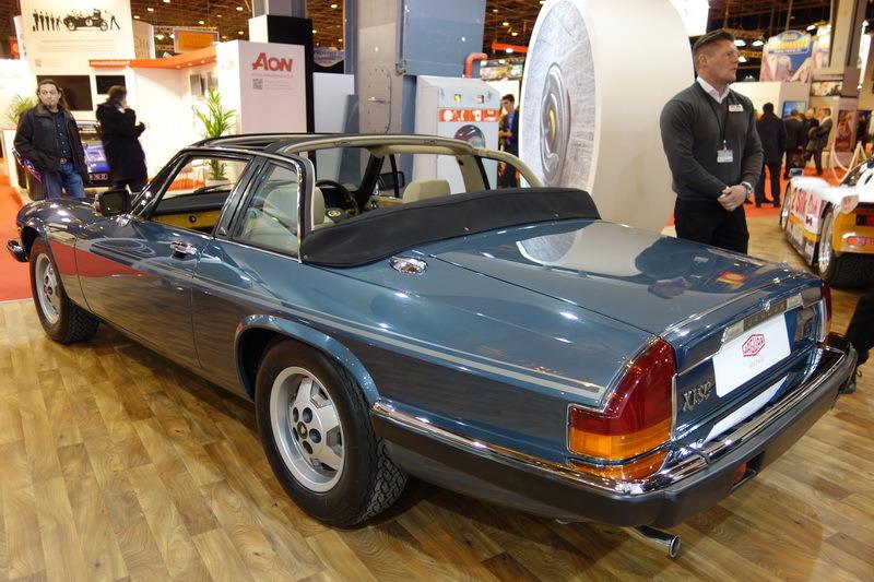

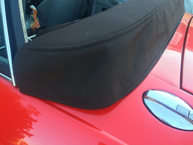

    • #7236
      Interesting thread until today as far as I was aware all hood covers were the same, Yet although Martin says his was made from one borrowed & used as a pattern something looks wrong, Compare the following photos & see if you can see what I mean. It looks as though the hood has not been folded correctly only last weekend Bryan had to show a lady who has owned her Cabriolet for 20 years how to fold it & her cover fitted perfectly for the first time in 20 years.
      [photo 849] [photo 850] [photo 851] [photo 871]
