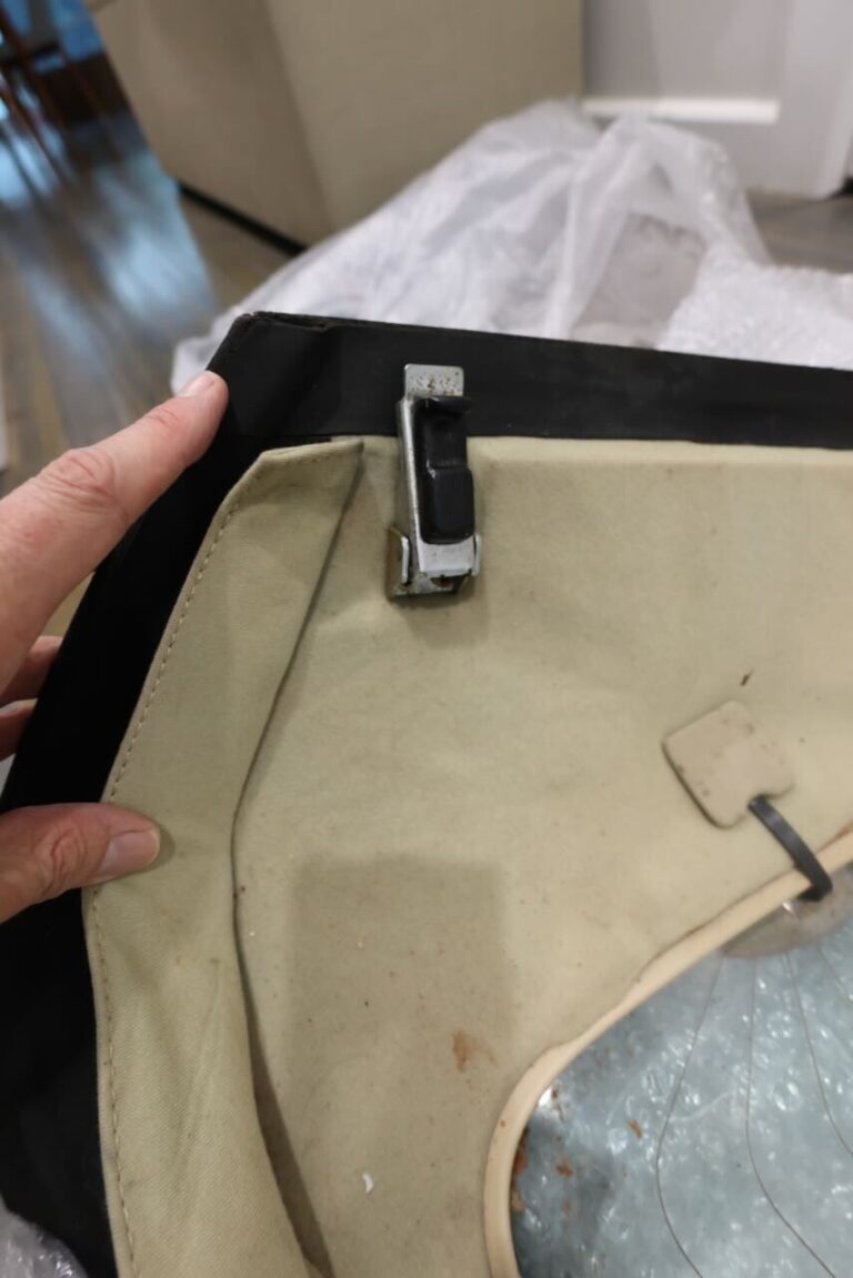

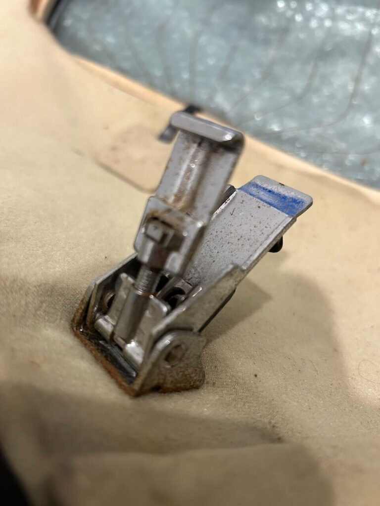

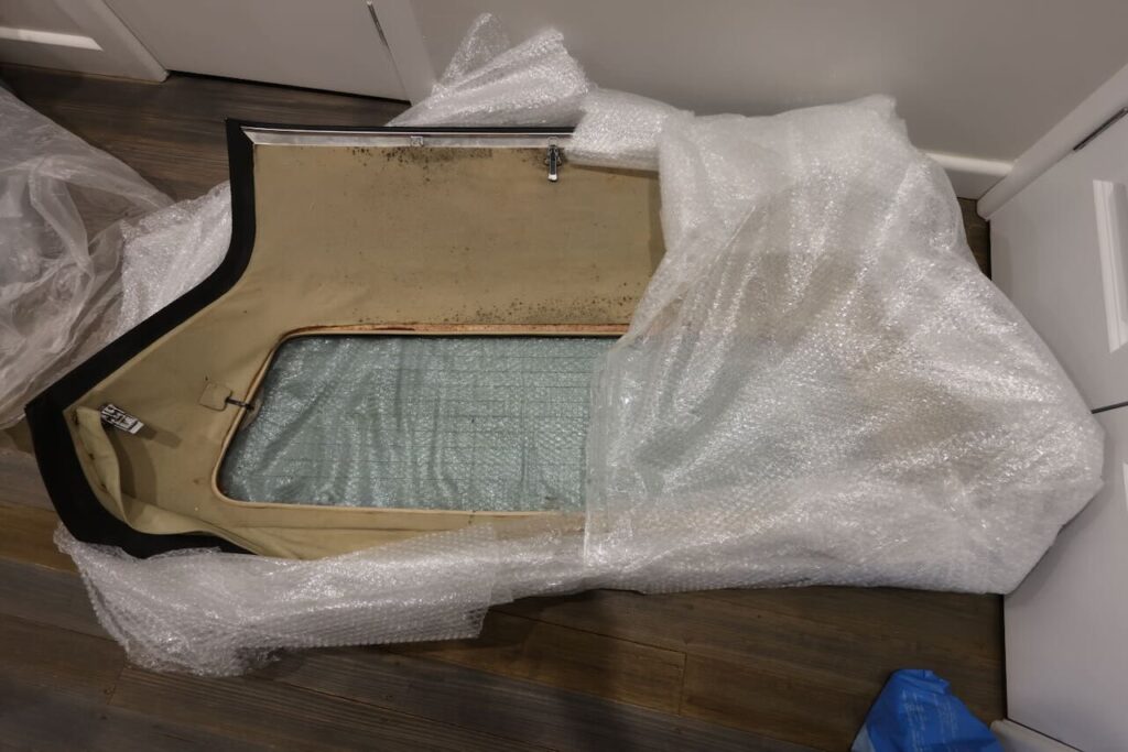

Hi Experts, feeling really chuffed to have recently picked up a Hard Top for my Cab. ย The thing is that this hard top’s fittings seem a little different to the others I have seen in pics. ย I’m based in Australia, so anyone in Aus that has a hard top, can you confirm whether these clips / fittings look normal? ย Also, there is a clip at the centre top of the roof. ย I have no idea what this attaches to, as I’ve never seen this before either. ย Any tips, photos of the attachment clips that others actually have on their hard top would be appreciated. ย Thank you, Adam

      UK supplied hardtops were fitted with 2-No locating clips on the leading front edge of the hardtop which align with 2-No locating clips on the cars roof centre beam (These are locating clips without any clamps). there is no front centre clamp fitted, There are 2-No clamps fitted the lower rear of the hardtop one on each side as per your photo these attach to the cars body using a bolt which passes through a hole in the clamp a screws into a threaded hole on the body work of the car. The brackets fitted on your hardtop don’t have the holes to allow the clamps to be bolted to the cars body, having explained how UK hardtops fit I see no reason why your clamps should not work as long as you have the correct mating pieces which would need to be mechanically attached to the cars body.

      Hi Brian, thanks very much for your reply. Yes, I have the two 2-No locating clips on the hardtop leading edge so all good there, as they are on my soft top. Not sure why a PO put a central clamp / clip on mine, but I will remove this before getting the headlining recovered.
      It appears I am missing the connecting pieces that bolt to the side c-pillars to receive the hardtop “hooks” on each lower side. Are you by any chance selling these clips that you’ve shown in the pics? They seem to be slightly different hardtop connectors to the ones I have on this roof, and I can see the bolt holes that attach allow for attachment to the c-pillars in your pics. Regards, Adam

      I guess the PO fitted the central front beam clamp as added piece of mind to ensure the top did not detach in the unlikely event of the rear clamps becoming undone, sorry my clamps are not for sale as they are needed for my car. Finding genuine Jaguar Clamps is almost impossible as I have searched everywhere i can think of to find a pair without success. RS Components sell a very similar clamp to the Jag original but differs at the connecting point and is similar to the ones fitted to your hardtop attaching to the C-pillar with a hook arrangement as apposed to a hole/bolt through set up. Good Luck in getting sorted with something that works

      Hi Brian, thanks for your reply mate. Yes, totally understand that you need yours. I took a punt as they were photographed on a sheet of white paper so hoped that they were a spare pair. It’s strange that there appears to be two types of latches used. Perhaps the ones with the eyelet bolt holes that you have were a UK delivered item, and the latches with the hooked ends were an export type. It appears that the latches I have are the same as a friend in the USA’s hardtop. He had to get the C-pillar attachments machined up. I may need to do the same. Appreciate your knowledge and advice. Thank you, Adam
