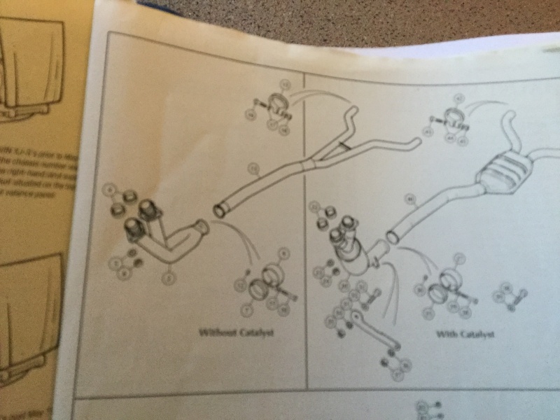

      i am asking this question to Longlife as they did say it included the front pipes, but not sure if this referred to the manifold.
    • #11506
      Hi Norman ,
      The price includes the front down pipes but not the manifold. In the diagram mine is the pipes without the cat.
      [photo 1207]
    • #11508
      Sorry this picture shows the front pipes.
      [photo 1208]

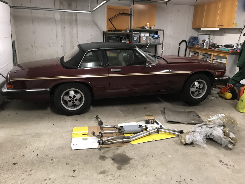

    • #12782
      Just had my car fitted with a stainless steeel exhaust by Longlife in Hull.  I love the sporty, throaty sound of it now which gives you the impression of more power.   I retrieved most of the old system which consists of the front “Y” pipe, the 2 front boxes, the offside rear box and the offside over axle pile.  The rear box and pipe is only about 1 year old.  If anyone needs these please make me an offer.  My car is a 3.6 manual.

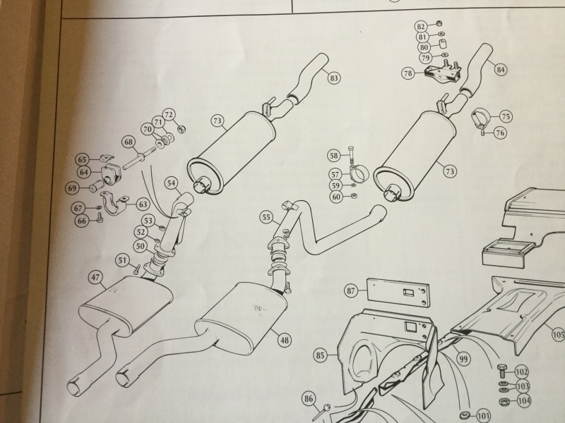

    • #14754
      Mats Johansson
      [photo 1649]
