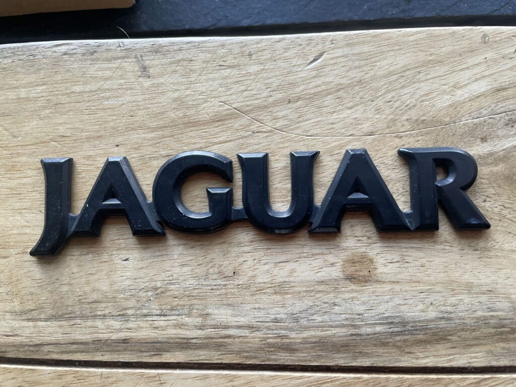

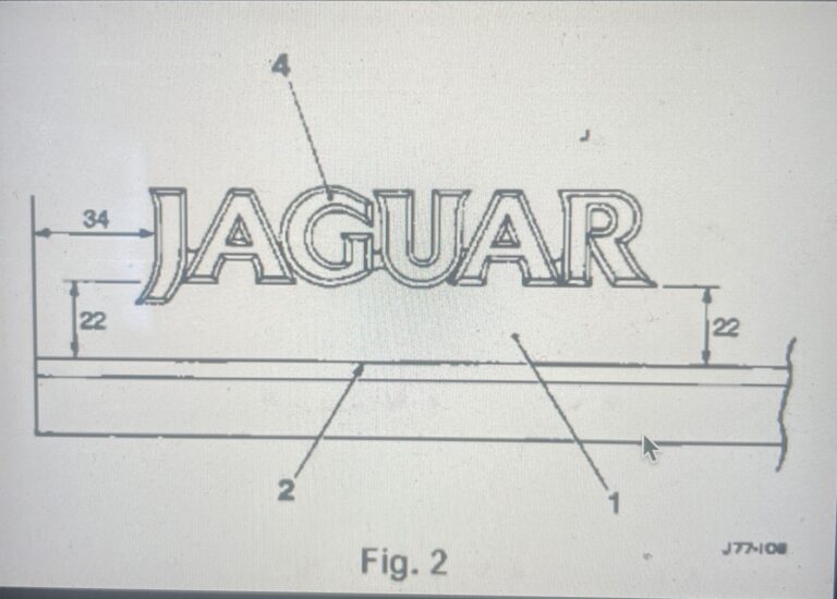

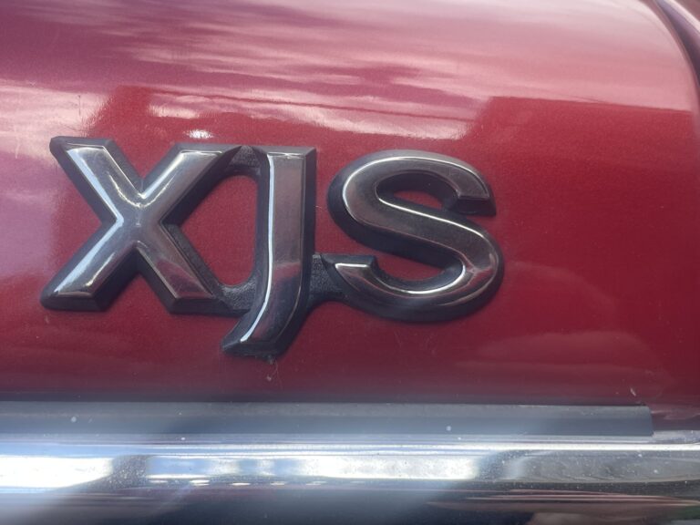

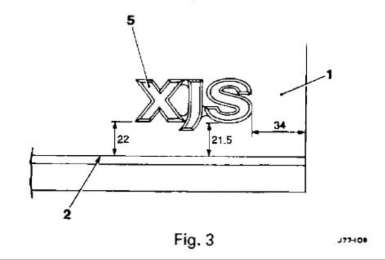

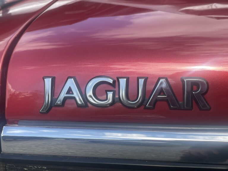

Could someone please give me accurate measurements for where the Jaguar and XJS badges go on the rear boot edge on my 1994 XJS Convertible. They were taken off for a respray and I’d like them to go back on exactly in the right place.
I’ll be putting new badges on, as the originals have no chrome left on them.

      I received some helpful information about the placement of these badges.
