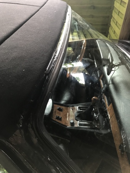

      Gerben Haringsma
      [photo 1336][photo 1337][photo 1341][photo 1338]
    • #13162
      Gerben Haringsma
      there was indeed a hole rusted through.and a small one on the right side of the car.
      painstakingly cleaned the area,welded and made smooth with lead. sanded and painted.
      ready for the final paint and new fabric.
      for which we will need the new rubber,or make one ourselves.
      problem almost solved.

    • #13276
      Hi Gerben,
      It is good and brave to tackle this job but my concern would be the quality of the retrimming of the roof material.  Do you have experience of this type of work?  How far are you taking back the roof materiel as I see at this moment you seem to have cut it back at the 1st seem above each door.  The top of each front pillar looks like a difficult area to recover without any creases.  It would be good to get some feedback about this process.  I have gone on Aldridge’s site and they show a price for the folding roof and material for the Targa panels but no mention of materials for this job.  I presume you would have to speak to them direct to get an off cut for the front roof area.  I live in York and I find it difficult to get a quote for a job like this as the extent of work is unknown until a full strip down is complete.  A big question mark would be the removal of the windscreen.  This is a challenging job so thanks for your feedback.
    • #13299
      Gerben Haringsma
      Hello Alan,
      i did not remove the windscreen.rubber is fine nd probably replaced in the past.
      along the chrome trimming,i cut away the rubber ,leaving a wide enough gap to glue the new material.
      i intend to reposition the trimming and to fill the gap with a good quality kit, like in my case teck7,
      the big problem will be ,to carefully avoid the kit coming on the new fabric,but i think it can be done with good quality painters tap on the fabrick.on the other side, the chrome trimming will give no problem.
      will put pictures whenn job done.oo and i will do the whole thing,including the targa pannels,as the material is not that expensive and i donot want clour differences.

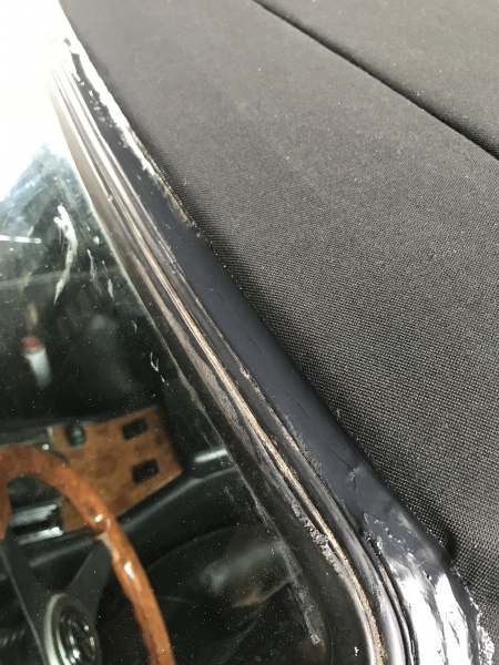

    • #13300
      Gerben Haringsma
      [photo 1352]
    • #13306
      Hi Gerben,
      I look forward to seeing the completed job – is teck7 an adhesive/sealant?
    • #13308
      Gerben Haringsma
      [photo 1353]
    • #13310
      Hi Gerben,
      Thanks for the explanation, and as you say you need to keep it off the upper side of the roof material.

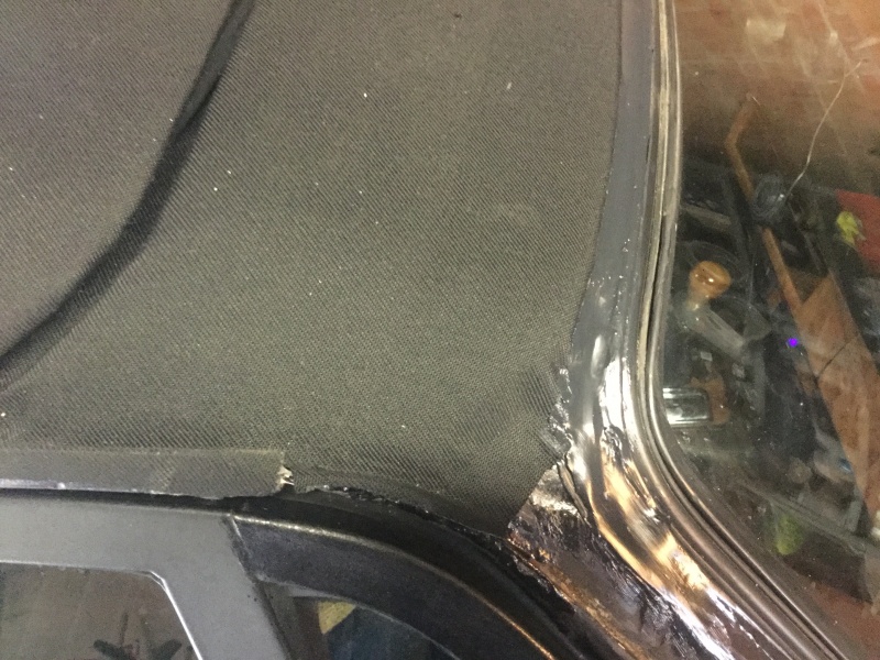

    • #13512
      Gerben Haringsma
      this picture thing is more difficult thenn the roof job !
      the roof has been recovered,the cut away rubber refilled,and as soon as dry,the trimming will be put back.
      also not an easy thing to do well !
      i tried to fit before the kit and there is no easy fit anymore.the chrome has to be re-bend at places,where you
      would think after all these years the shape should be fixed.allas no..
      the good thing is,that the new (very thin) fabric used,is coated with a thin layer of rubber.water cannot go through
      the fabric onto the paint/metal of the roof ! this puts my mind at ease for the future (a bit).
