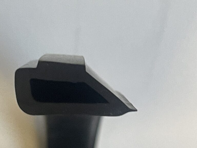

Can you let me know what is included in the Targa roof seal pack please. I have a 1984 Cabriolet and now have fitted a hard rear top to replace my original where the rear window had gone virtually completely cloudy, what an improvement !! but may well be interested in the seals.

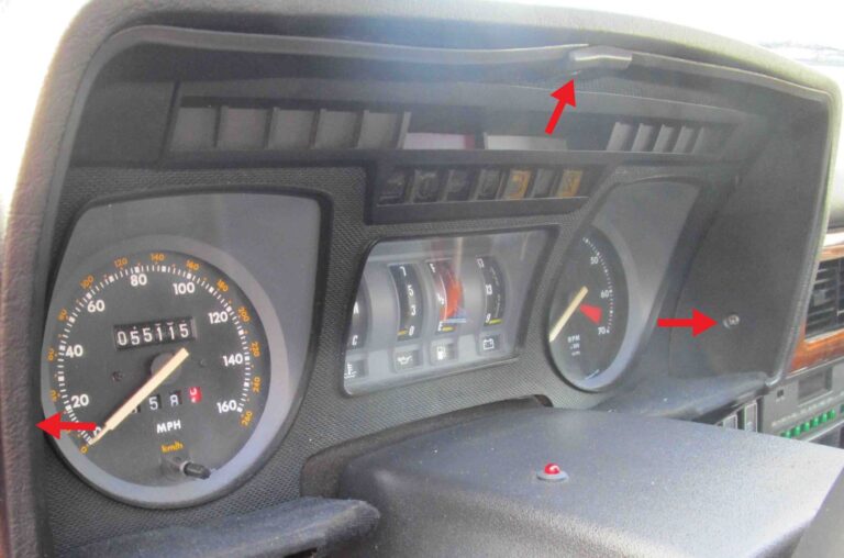

I am currently trying to remove the instrument binnacle so that I can change the instrument lights to LEDs. I’m really struggling to get this out without breaking.

      The Targa roof seal is a length of seal rubber that has been manufactured to the same profile as the original that is used for the Targa panel and the rear fold down roof/hard top. There is an article that gives further information :
      Article : Targa Seals
      2) there is an article that I wrote a while back, that details how the instrument binnacle is removed (my solution for better lighting was to remove the green covers)
      Article : Instrument binnacle

      Taking off the steering wheel certainly makes the binnacle removal easier
