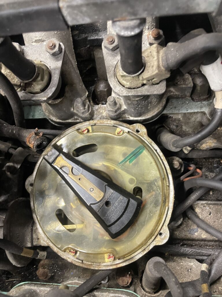

The original problem eventually led me into the Lucas distributor, where I discovered a broken wire connected to the ignition pickup. That seemed sufficiently promising, so the damaged pickup and wiring were replaced and everything carefully put back together.
Then when I couldn’t get the car started at all I discovered the supplied lead from the distributor to the Amplifier was wired the wrong way round (I swapped the wires at the Amplifier plug and the car fired up).

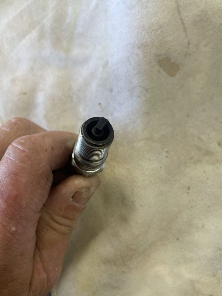

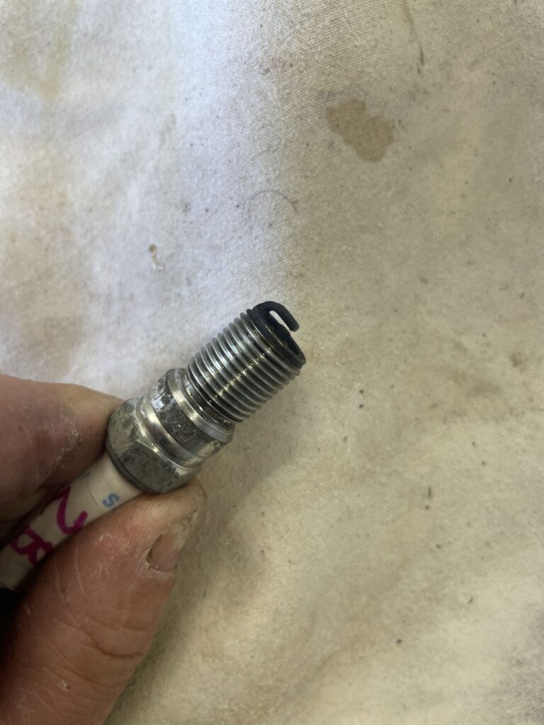

I’ve removed and checked a couple of the spark plugs, and though they don’t look the best, I don’t think they are the main cause of the rough running (feels like it’s almost half not firing).

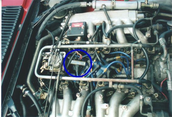

      Check that your front coil is still working.
      The best solution if you haven’t done it already, is remove both coils as if the front one is faulty it will interfere with the other coil, and replace with new single coil #DAC 6093, Ducelier coil – 0.62 ohms primary, that was fitted to the later V12’s.
