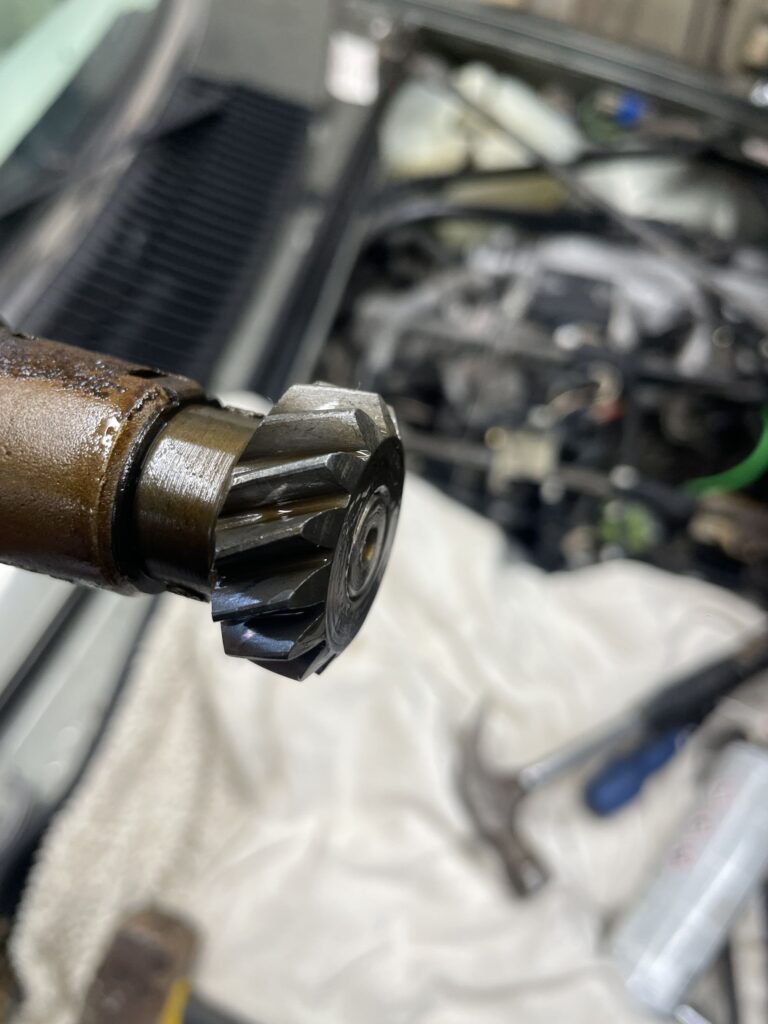

MY 1986 V12 XJ-SC Cabriolet was up and running, but had a slight miss-fire so I replaced the Lucas distributor cap and the Rotor Arm. When I pulled the old Rotor Arm off it raised the shaft a few millimeters and I tried to push it back down when I pushed the new Arm on but it didn’t quite go back and I left it like that – here’s the cause.
Then when I’d put everything back together and turn the key to crank the engine, the engine jammed up (presumably on the incorrectly located distributor shaft).

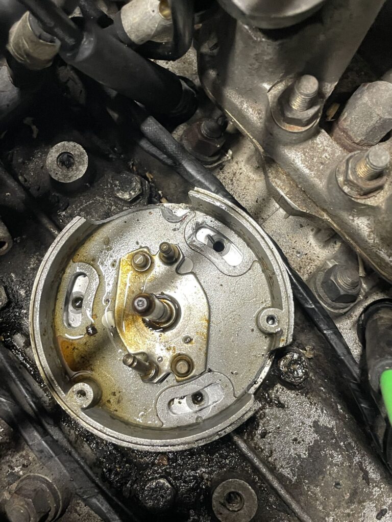

So, I tried to remove the distributor, working on the premise that it might unjam on the engine as I pulled it out. I discovered all the advance mechanism was broken, presumably due to being out of position when I cranked the engine. Removing the distributor has proved extremely hard to achieve, and basically I’ve ended up where shown in the photo.
I can rotate the last remaining part of the distributor casing (very very stiff) by leveraging the broken bits of case (another self inflicted issue) and the engine bolt (to the right of the picture).
I figured that as I can rotate the case a few millimetre then the seal is broken and out the distributor will come – no such luck.
I’m now completely stuck. The casing and the remains of the shaft are basically stuck, and the engine is still very much jammed (verified by gently rotating the engine the correct way and backwards on the crankshaft pulley, rather than attempting to crank the engine again).

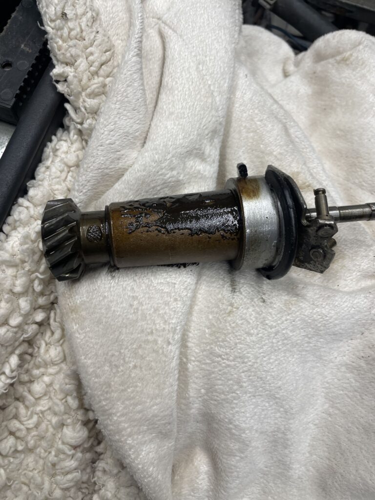

      After a lot of effort to get the jammed distributor out, I succeeded – only after carefully rotating the engine backwards on the crankshaft bolt, which freed the Jam and the remains of the body and shaft came out (I say remains as I basically destroyed the case and everything else trying to get it out when it was stuck in place…).
