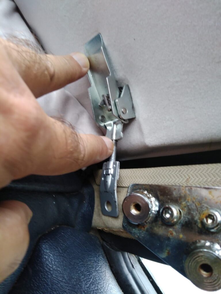

Fitting the hardtop was relatively straightforward but once again the handbook could have been more helpful – a picture would have helped — I was thinking the over-centre catches each side on the hardtop must fit into the same brackets that the soft-top uses….no, the brackets need to be removed, then under the lining fabric is a third, lower, hole to bolt the over-centre catches to…in my case there was no hole in the lining fabric, which suggests that a hardtop has never been fitted to the car before.

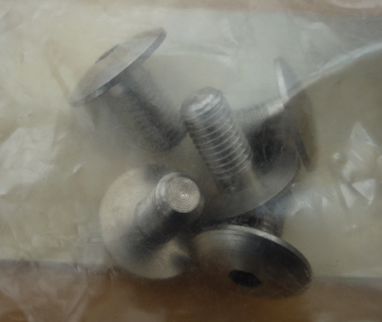

      You can buy the replacement bolts for refitting your soft top, on eBay
      Click Here

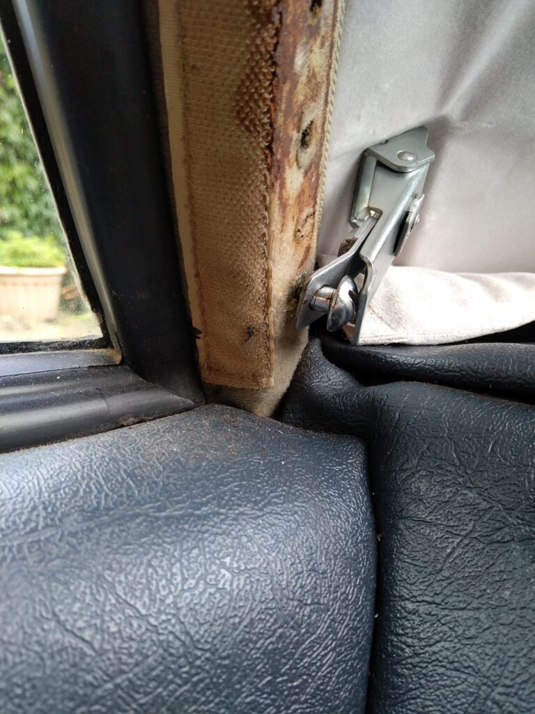

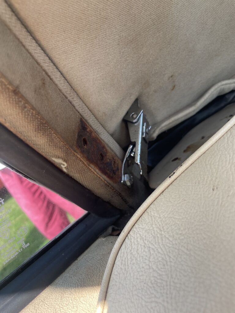

      It doesn’t seem to look too good once you’ve removed the soft top bracket after years and years of being there – someone mentioned that they’d heard there was a plastic piece that fitted here, but we couldn’t determine whether it was to hide these “spare” holes or to sit over the hard top bracket in some way. Does anyone have photos of what this might possibly be, or bright ideas on how to tidy up the historic fixing marks ?

      You’re right — the rust stains left by removing the soft-top bracket do look bad….I was thinking of getting a piece of fabric to match the interior upholstery (blue in my case) and velcro-dot’ing it over the top….could even get a matching bit of leather / vinyl.
      Keith

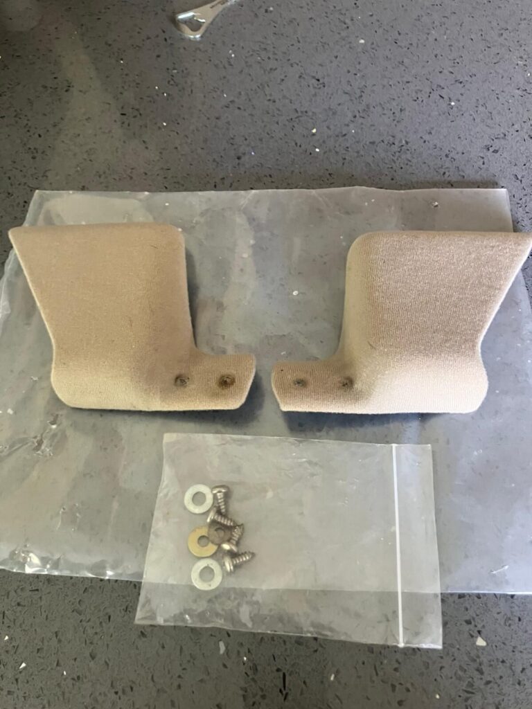

      The hardtop when supplied new were provided with covers which conceal the latches, i have attached a photo of the set i have but as yet have never fitted so not quite sure how they secure to the car. but i guess these also cover the unsightly holes visible after removal of the soft top.

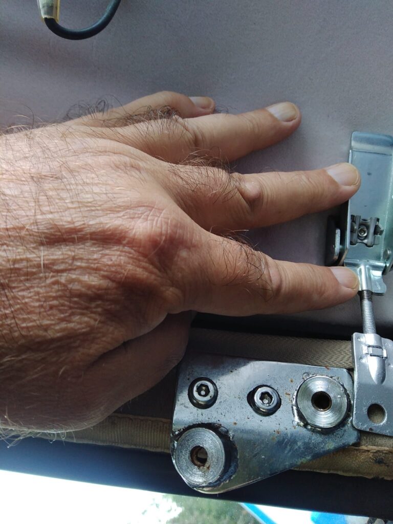

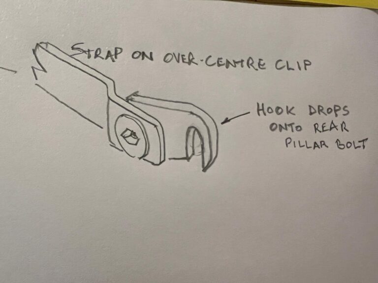

      Just doodling, and was wondering whether a hook on the catch would make it more convenient to remove the hard top (thereby avoiding the squeeze into the back of the car to undo the two bolts).
      Keith

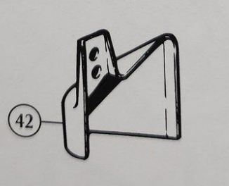

      Looking at the Jaguar part’s diagram for the hard top it looks like the covers, that Brian has shared a photo above, fit with their two holes upwards. The image below is for the right hand side (when looking from the front seats towards the hard top.
    • #26626
      In case anyone is interested, the part numbers are :
      BAC6087ND – JAGUAR HARDTOP CATCH COVER (right hand)
      BAC6086ND – JAGUAR HARDTOP CATCH COVER (left hand)

      @bbuxton, Hi Brian, I’d still be interested in the latches you mentioned in my post previously. Also, those covers you have shown in the pics above, if they are for sale, I’d be interested, as I do not have these for my car.
