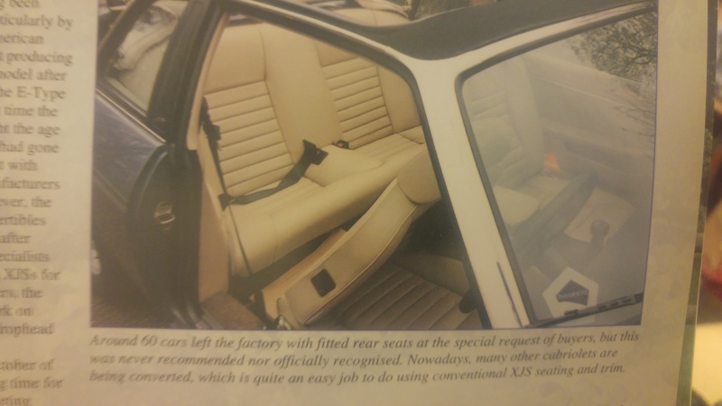

    • #12556
      Steven Foster
      [photo 1291]
    • #12562
      Just joining the conversation, those belts look like the ones in the back of mine, not inertia style but pull to tighten Steven.
    • #12564
      Hi Jon,
      I assume from what you are saying is that a factory fitted one would be inertia?
    • #12567
      Alan,
      Looking at the picture from Steven, if in theory that was one that came from the factory then those seat belts are not the normal inertia style that the front has, but a pull and tighten, but could also depend upon what was around?? Although I remember the coupe my dad used to have had inertia sea belts in the back and it was a similar age to the cab.
