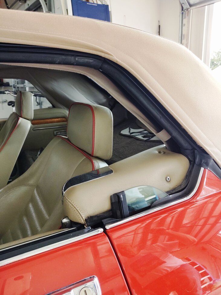

Hi All
I have a 1991 XJS V12 Convertible, unfortunatly the rear windows are not coming back up when i close the roof, any suggestions?
Thanks,
Tony
Picture is a Library Picture, not my car
