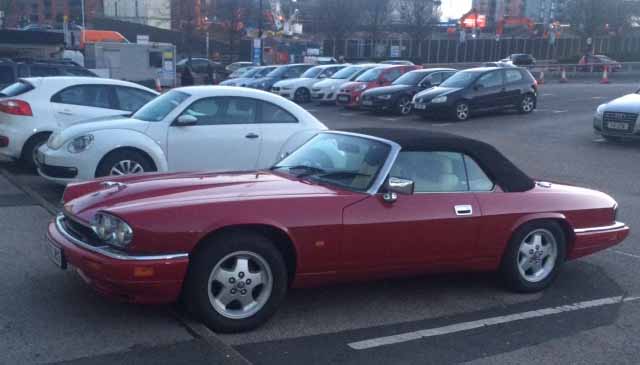

The brakes have faded and gone a bit squishy on my RHD XJS Convertible, after the car’s been sat for a month.
[photo 201] so it’s of to the garage after work for some remedial work.

      I’ll know later in the week, once the garage have taken a look – initial thoughts are that the fluid is passing around the piston in the master cylinder, and then when I pump the brakes it all comes back round again. It’s the last bit of the braking system that hasn’t been replaced so is the likely candidate.

      Picked up my car from the garage tonight – all sorted.
      Turns out the fluid was going around the piston rubbers in the master cylinder, effectively making them completely non effective. Once had pumped them the fluid moved back around the rubbers and sort of gave some braking power again.
      New Brake Master cylinder fitted and good firm effective brakes now – and the bill wasn’t too bad either.
