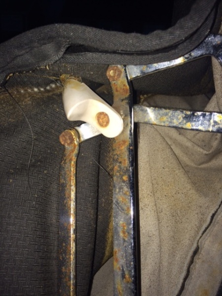

      I’ve taken a couple of photos.
      [photo 1097]
      This white piece should sit firmly against the window frame of the rear side windows.

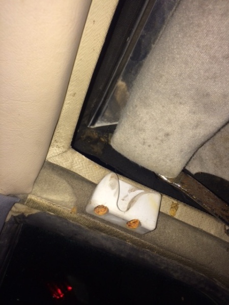

      [photo 1098]
      This shows the catch, either side of the car, that the bar at the top of the hood should engage with. If you don’t have these slotted in on each side I doubt you’d be able to get the top of the hood to engage with the two targa catches, so I’m guessing you’ve not got a problem here.

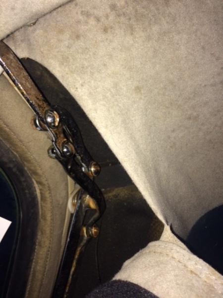

      [photo 1090]
      Bit difficult to see in this photo, but this is what it should like within the car when the hood is fully closed and locked in place. No gap here between the hood itself and the window frame of the rear side window.
