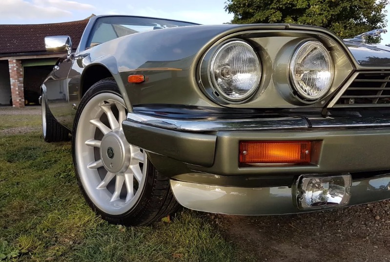

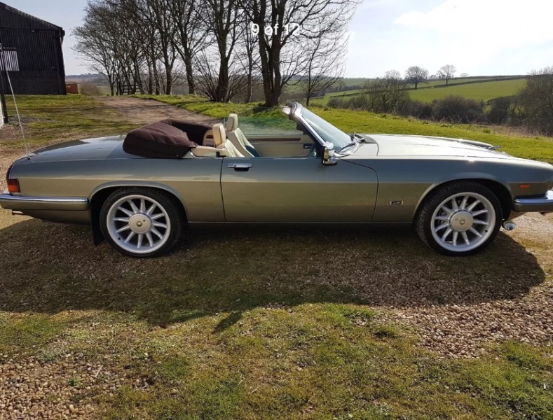

21st June 2017 at 17:27 #5337RobinParticipant
I have seen a couple of XJS’s fitted with the 18″Aston Martin DB7 Turbine alloy wheels and Pirelli P Zero tyres.
As the DB7 is practically a mk2 version of XJS I gather these fit. Not my taste but there is currently a convertible on eBay with these fitted so you can see wheel fit.
I’d put a link to listing but not sure how – so check out Alpine green 1988 convertible – ‘reduced’ to £15,500 on eBay – 5days until ends.
Aston wheels are often available as owners update the early DB7 wheels for later versions – cost even more than Jag ones when new..Robin
22nd June 2017 at 07:46 #5345Laurence JonesKeymaster
Trouble with EBay links are they get archived by eBay and disappear
Here is a couple of photos of the car Robin mentioned
[photo 701]
[photo 702]
I had these fitted to my grey can (still got a set of spacers somewhere from it)
