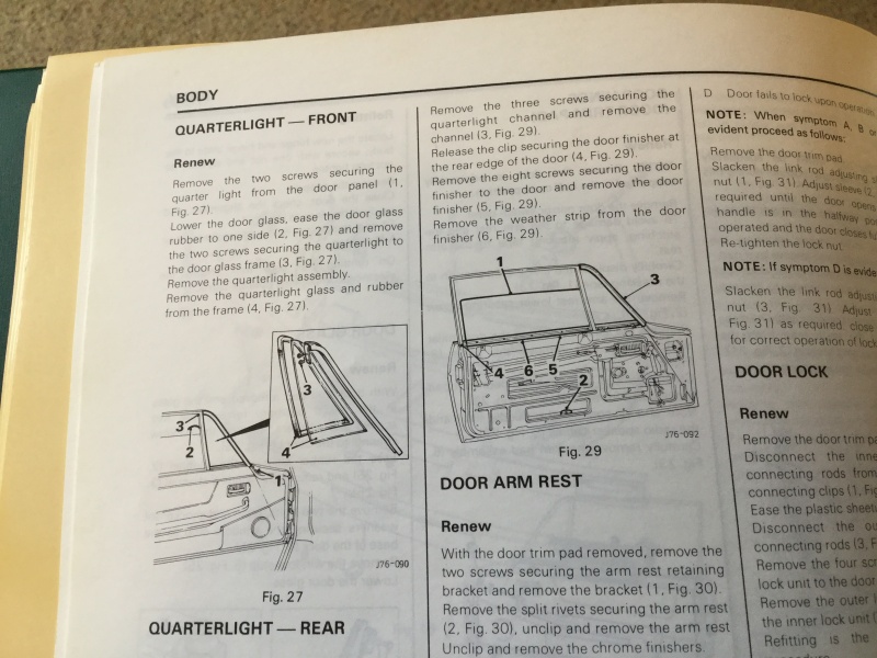

27th November 2017 at 10:41 #9760Anonymous
I am a new member and have an XJ-SC. I have. Just replaced the front quarter light window seals and the correct way is to remove the frame that supports the window. The screws that hold the frame are shown in an original repair manual. Sealant will make it slightly difficult to pull the frame away but I think is easily done. The longest job is cleaning off the old sealant.
One major thing to think about is the condition of the quarter light support plates that fit at the bottom of the glass that are attached to the door. These are usually very rusted and need replacing. I managed to get 2 from a breakers yard as they are difficult to find. I have 1 reasonable spare one if needed.
If this any help please contact me for more info.
Hope you can read this procedure.

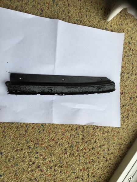

5th February 2018 at 10:30 #11658Anonymous
When replacing the door Qtr light seal you have to consider the condition of the window support. The window support plate attaches to the door by 2 screws and usually they are very corroded depending on the condition of the seal. They are a rare item to find in good condition, even from a breakers yard. The one in the picture is the drivers side panel and you will see it is shaped to the contour of the door. I was lucky and managed to get the last 2 from grub locker. This one is pitted but can be reused. Fortunately the rust is only confined to this piece and not the door frame, mainly because it sits on a bed of mastic. To complete the qtr light seal replacement took me about an hour and this includes taking off the door card. A little more time was given to applying wax oil to the door inner panels.
5th February 2018 at 11:00 #11660Anonymous
Has anyone replaced the rear qtr light seals as it looks as if there are similar plates below the window which are obsolete part No’s BAC7739/38. Fortunately my seals look ok but I wonder what condition these plates are in.
